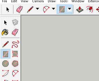

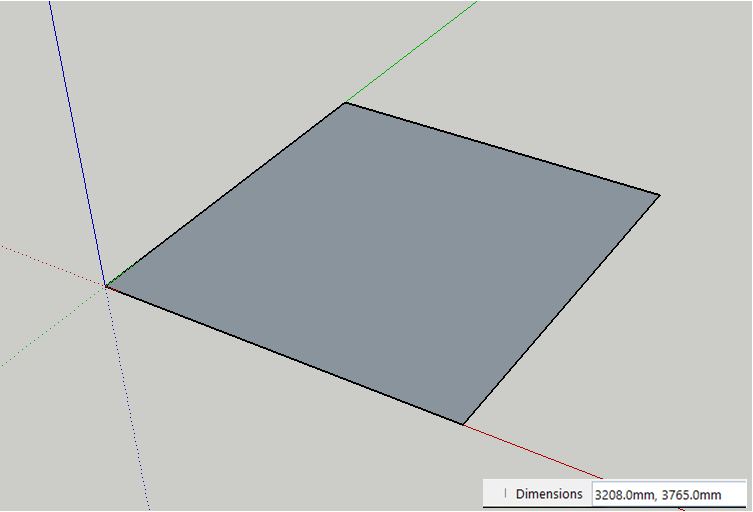

Create a floor plan or guide to follow by using the shape tool on sketch up or using an actual floor plan.
Insert the dimensions according to the areas specifications.

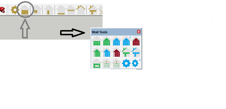

Step 2

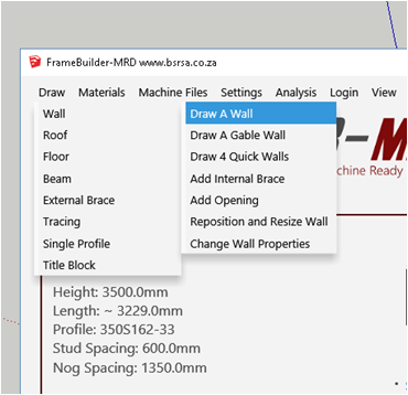

Click the Wall icon as shown above.
Click the wall icon .

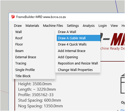

 For gable or shed walls click the gable wall icon.
                          OR
On the menu go to Draw>Wall>Draw A Wall.
And for gable or shed wall tool go to Draw>Wall>Draw A  Gable Wall.

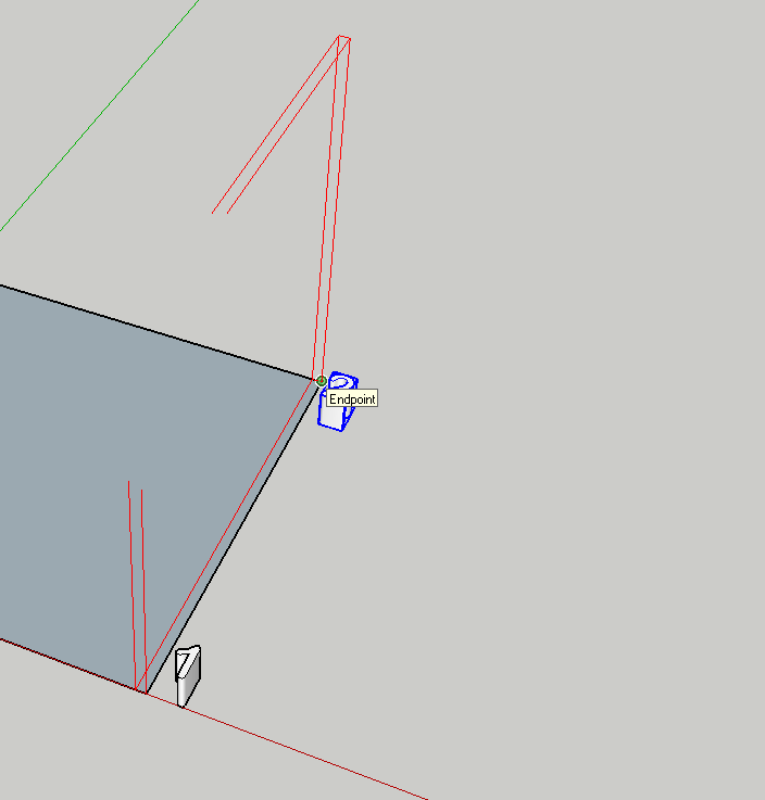

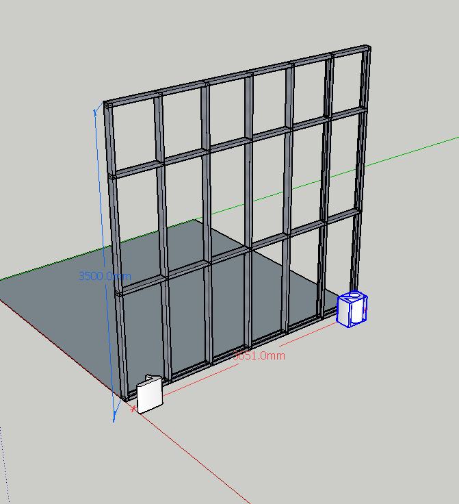

Step 3
Click with the cursor from one point to the other as shown above (from point 1 to 2).
The wall will be drawn.

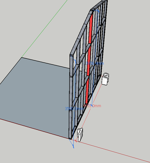

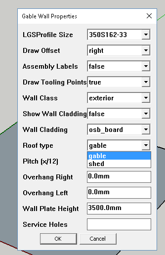

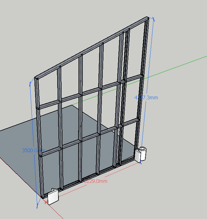

Step 4 For gable wall.
For gable or shed walls specify the roof type.
The gable wall will be drawn.
The shed wall will be drawn.
